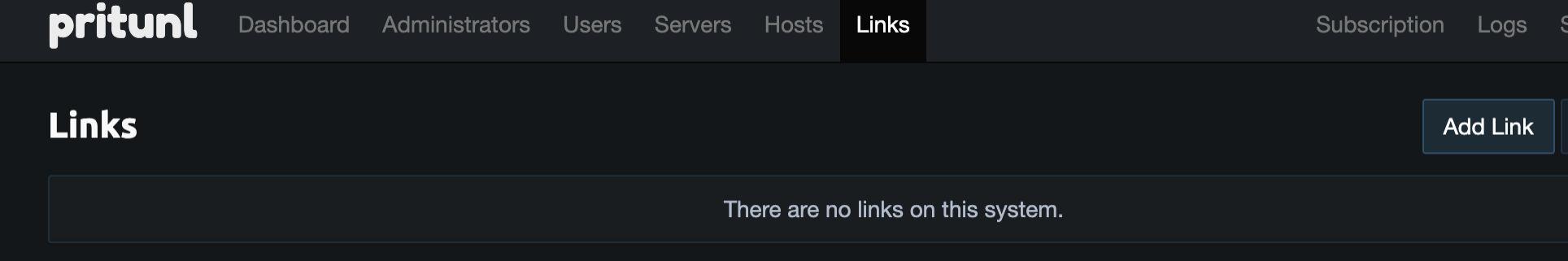

Do you have linked servers configured linking those two servers in Pritunl, it likely shouldn’t be for that use case?
Sorry, if you’re referring to Pritunl Links, then we don’t have any configured.

Pritunl Link is separate from the server links. The server links would be shown in the servers tab the links would be displayed below the list of hosts in the server.
If you don’t have source/dest checking disabled that can cause issues. If the traffic is only going to VPN clients it would remain on the VXLan but for that configuration there would be not use for the VPC routes. The security group will also need to allow all traffic from the VPN virtual networks for both servers.
Ah, sorry for the confusion.
And no, we don’t have these configured either.
The servers in question share the same 3 hosts.
The documentation ( Server Links | Pritunl VPN | Pritunl Documentation ) is not very clear on what this feature does or how it works,
but looking at the code,
it seems like it uses openvpn to, well, link multiple disjoint servers together.
As far as I can tell, the code has checks preventing creation of links between servers running on the same host,
so it thankfully wouldn’t have allowed us to misconfigure this anyway.
Sorry for the confusion.
