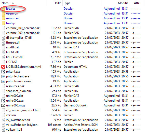

I come to you to know if we can change the interface of the Pritunl software on windows?
I would like to put it in french
I noticed that there is a local folder at the root of the software, is that not where the languages are?
Otherwise I can help you if ever the software is not translated
Thanking you
There isn’t any option to change the language or any easy way to write other languages. Electron has support for locales which is what that directory is for but this functionality was not utilized when writing the client code.
