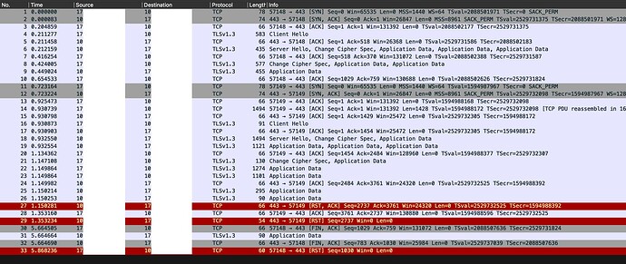

A tcpdump captured on the Pritunl server seems to show the TLS handshake ending with a TCP RST. There is no traffic between the server and the client afterwards.

We tried lowering the “Connection MTU” to 1200 on the server, but it didn’t helped.
We also tried to recreate our VPN server on AlmaLinux 9.5 to benefit from more recent packages, but the same users are facing the same issue on this server too.

It’s failing on the pre-connection authentication which is done with a web request to the Pritunl web server port. It wouldn’t be effected by MTU or any settings with the VPN. Check for errors in the server and verify the CPU or memory are not overloaded. Also run sudo journalctl -u pritunl -n 5000 and look for errors coming directly from the web server process.
Running sudo pritunl set app.web_systemd true and sudo systemctl restart pritunl may help if there are resource issues on the server. Then run sudo journalctl -u pritunl-web -n 5000 and check for errors from the web server.
When an impacted user tries to connect there is no log showing for pritunl or pritunl-web. We tested that with app.web_systemd to false and true and there is no difference.
