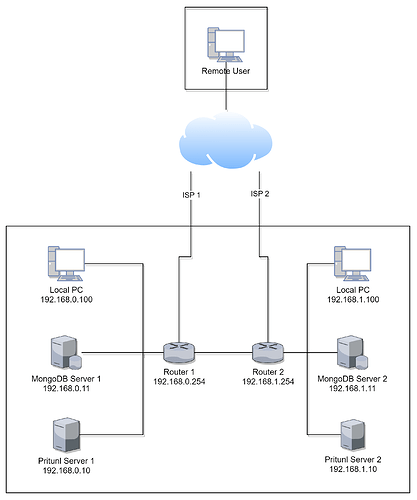

I would like to ask if below scenario is possible to do with pritunl VPN or not? If yes would anyone be able to provide configuration example?
I have 2 routers with separate internet connection for each router. Both routers have their own subnets to serve.
Let me try to explain what I would like to achieve:
I would like to use 1 VPN organization with 2 pritunl servers and 2 MongoDB servers. The 2 MongoDB servers would replicate between each other and the 2 pritunl servers would be failover of each other. Each pritunl server would have their own connection to the internet. Pritunl Server 1 uses Router 1 to access the internet through ISP 1 connection and Pritunl Server 2 uses Router 2 to access the internet through ISP 2 connection.
When client connects it would try to connect through the registered domain name of ISP 1 connection but if that is not available then client would try the registered domain name of ISP 2 connection.
If both sides are available then connection would be always through ISP 1. While connection is live but Pritunl Server 1 goes down the connection would automatically failover to Pritunl Server 2 using ISP 2 connection. I understand that each pritunl server would need separate virtual subnet which will require static routes accordingly.

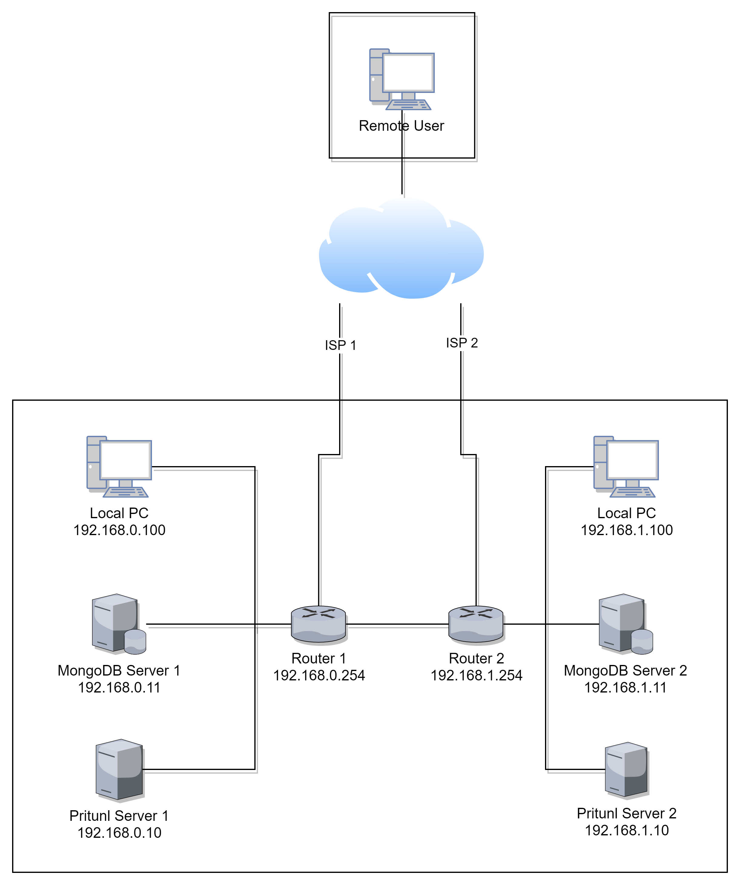

In the given configuration example (picture that was posted) we have 2 sites where both sites are connected to each other through site-to-site VPN. VPN connection is between Router 1 and Router 2. Each site has their dedicated WAN connection with registered A records for the pritunl setup. We would like to place pritunl host on both site 1 and site 2 so in case ISP1 or ISP2 goes down we can access the local network by the pritunl VPN. Also if any pritunl host goes down on either site the other will still provide connectivity.
To complicate things we would be looking for a non-NAT configuration so remote clients can be accessed from local network. Currently there are OSPF route advertisements going on between the sites and that is why I was asking about the OSPF option in pritunl. I can look into it if it is possible by python plugin to do OSPF advertisement but I will need OSPF plugin installed too.

Without custom code to update the routes a non-NAT failover configuration is only supported on AWS and Oracle Cloud.
