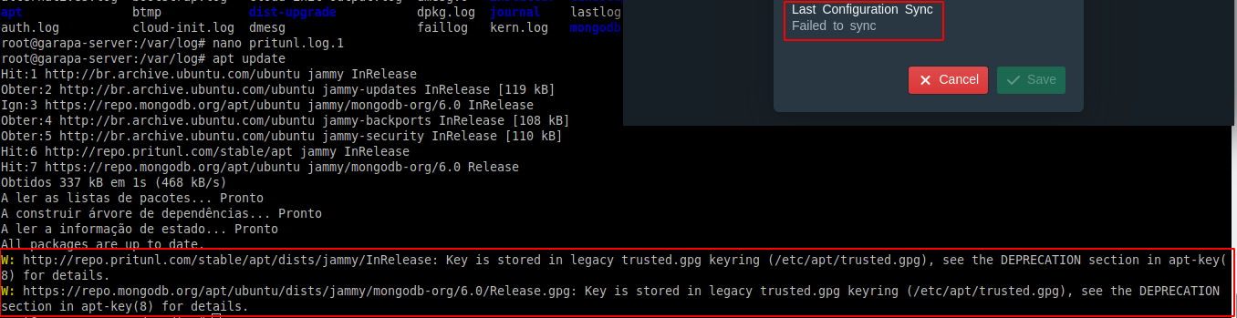

I trying to use Pritunl in my Ubuntu Server. I did the installation trough Pritunl docs [Installation], created an Organization, Server and my User, I made the connection between Server and Orga, but, when I access the VPN on the client, I can’t. This message appears in Profile Settings:

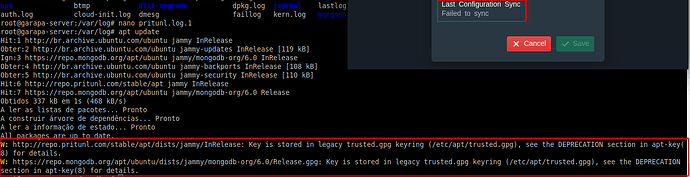

Also, this message always appears when I run [sudo apt update] after installing Pritunl.
EDIT:
I managed to solve the key problem. I made i:
$ cd /etc/apt
$ ls
$ cp trusted.gpg trusted.gpg.d/
$ cd trusted.gpg.d/
$ sudo apt update
OR
See this video.: https://www.youtube.com/watch?v=50qu4NUzijk

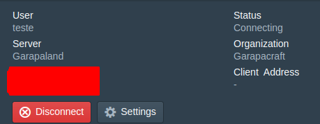

So, in order for me to use Pritunl’s VPN do I have to buy a subscription? Is that why when I try to connect to the Server, my profile status is “Connecting”?
If an option that requires updating the profile was changed that will require re-importing the profile.
Yes, but I always reimport the profile and it always gives an error.
I don’t know why it gives this error. I’ve restarted the service several times, reinstalled it several times, checked the keys and everything is ok. Anyway, I think I’ll try to work this out. Any news or solution, I will write here to help those like me.
