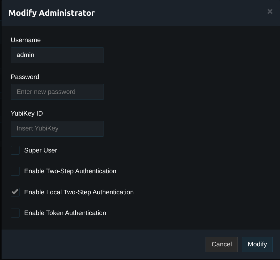

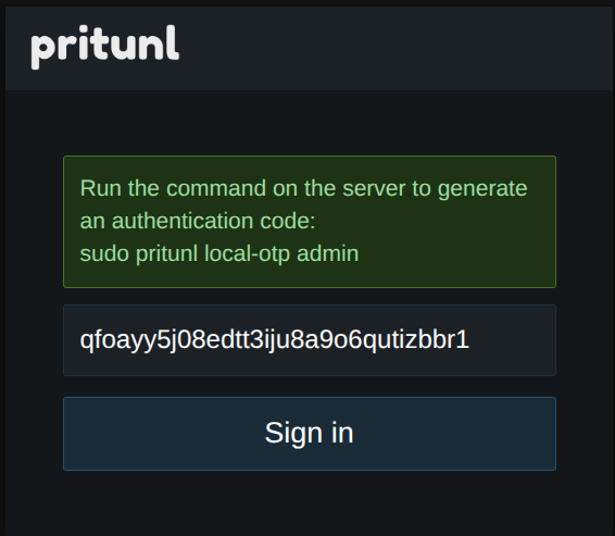

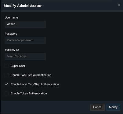

There is already Yubikey support for administrators which provides a very secure login. But I also just added a new local two-factor authentication method to resolve any concerns about the security of administrator accounts.
The new method requires running a command on the server for administrator logins. This will prompt the administrator to run a command on login and require full SSH access to complete an administrator login. After testing this will be included in the next release.
