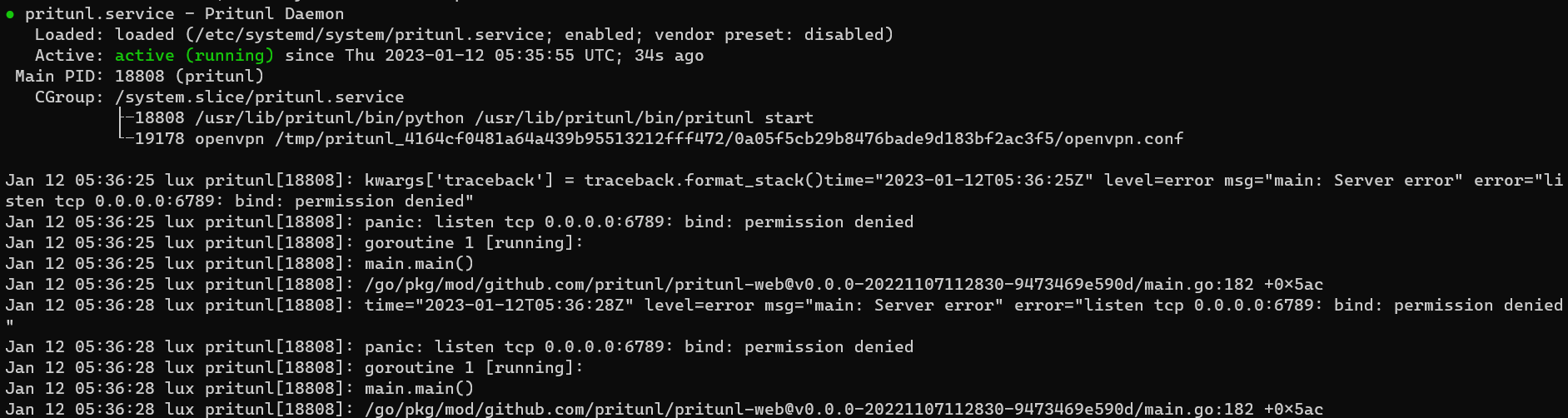

[fixed] Changing app.server_port to port other than 443 makes web console unable to be accessed, even when i open the port to firewall
My intention is to reverse proxy the web console under a different subdomain using nginx, so i can have 1 subdomain for VPN and 1 for my personal website. But when i change the port, it said “bind permission denied”
