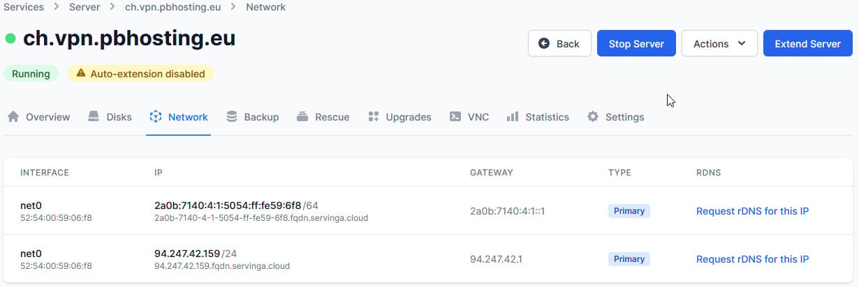

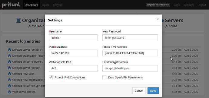

I just installed Pritunl VPN on a fresh Servinga-VPS.
Unfortunately the VPN-Server of Pritunl will not start with Error “Failed to start the server, server error occurred.”
I also tried different Server- and Organisation-Names including the mentioned “server” / “users”; but it still doesn`t work.

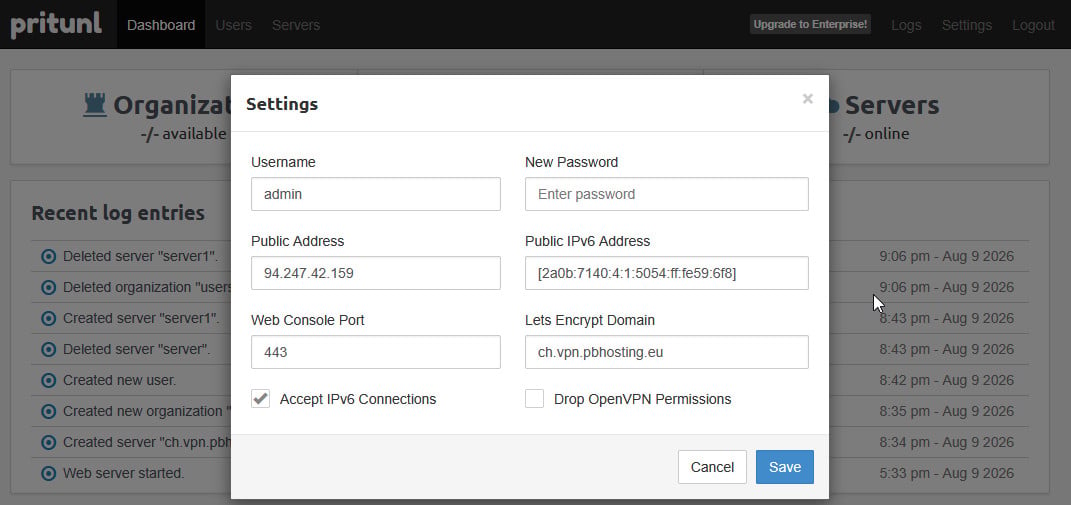

Settings:

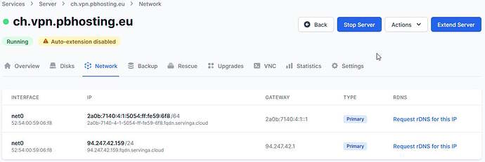

Network-Information of Servinga-VPS:
