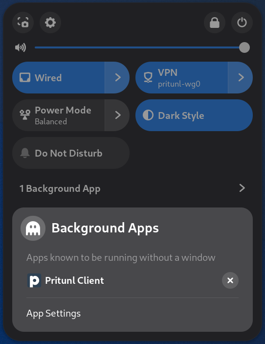

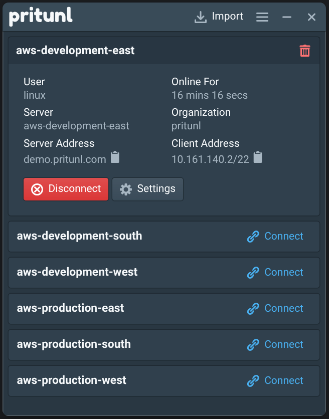

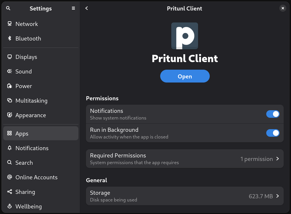

This has been added is now available in the repo at pritunl/pritunl-client/flatpak. The Flatpak client runs without root using NetworkManager and supports WireGuard connections. OpenVPN connections are currently not supported. The next release should be published to a Flatpak repo at repo.pritunl.com/stable/flatpak. The commands below will locally build and run the Flatpak client.
git clone https://github.com/pritunl/pritunl-client.git
cd pritunl-client/flatpak
rm -rf .flatpak-builder/ build-dir/
flatpak run org.flatpak.Builder --user --install --force-clean --disable-rofiles-fuse build-dir com.pritunl.Client.local.yml
flatpak run com.pritunl.Client
