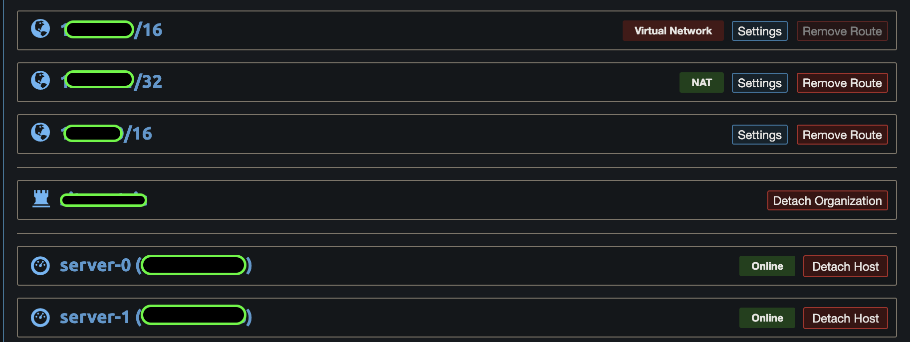

My EC2 instances that I am using to test are already being throttled at 100% using t3.mediums. I’m looking to not allow internet traffic be tunneled through the Pritunl server. However, I hope I am doing this right. I setup the Internal VPN following this documentation here with using Enable VPN Client DNS Mapping :
Once I got this setup, I added MASQUERADE of my /20 CIDR on my Pritunl Hosts and removed the Pritunl Settings 0.0.0.0/0 so I don’t route internet traffic through openvpn. Nevertheless, when I’m connecting to just 1 device, a t3.medium is hitting 100% CPU Utilization! Am I doing something wrong? I have a vanilla openvpn server that barely hits 5% when connected.

I resolved it. Doofus mistake on my side where incorrectly added the wrong IP: https://www.reddit.com/r/aws/comments/c2ysrm/using_rt53_for_internal_dns/
The documentation I linked previously can also be used.
I was using 10.100.0.1/32 which was tied to the server causing it to jump 100% CPU utilization. Now it’s 1% CPU utilization
