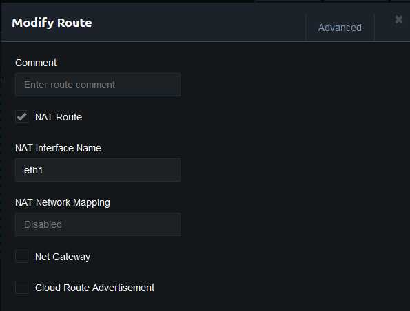

I have added a NAT interface to Route like this.
The route is not working. Another similar route where I put down the NAT Interface as eth0 works. I have added new interface after installing and setting up pritunl. I have reset service/reboot server/added new users/re-downloaded profiles etc to rule out those things.
Any help would be appreciated. Let me know if what I am trying to do is not possible, so that I can try to find any alternate products or solutions.
It may be a limitation of the current design, I haven’t tested this configuration.
Hi @zach Are you from Pritunl? Is this an official answer that this is an unsupported right now? If so, can I know the purpose of that particular field, or in what scenarios it would work?
I have an enterprise license and currently doing an POC to understand the features and limitations. It is crucial to know the limitations and maturity of the product.
Yes that would be the official answer. I would need to replicate the configuration to verify what is occurring but the recommended configuration has always been to create separate hosts when multiple default gateways are desired.
