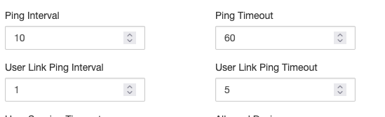

The client will automatically reconnect. Reducing the ping timeout in the server settings will reduce the time it takes for the client to reconnect.
I didn’t quite understand whether this setup has any additional benefit than the setup just multi host without replication, thank you.
Also could you be more specific about the ping configurations you are referring to ?
These are the only ping options I can see on server side:
Also if I change these settings while there are users using this server should they re-download their client certificates because I can see this configurations also being part of the certificate used to connect to the server?
Another thing I noticed recently is that when you have multi host setup without replication anytime you restart the VPN server there is no guarantee that the server will start back again on the initial host and this basically brakes the extra logic we have with iptables rules on top of PritunlVPN to restrict the access between peers. Is there a way to bind the host to the server somehow and only when the bind host fails to make the transition to the healthy host?
Maybe the correct way to avoid this behavior is to have multi host + replication in place, are there any downsides we can expect if we follow this approach ?
On stable connections the ping timeout can be reduced to 20 or the ping interval to 3 with a timeout of 10. The options are pushed on connection it does not require the client to update the configuration. There is also configuration sync with the Pritunl Client for changes that do require updates, this occurs on connection.
