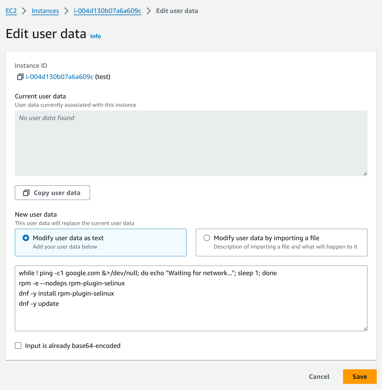

To fix this on AWS after the SSH server is inaccessible stop the instance. Then click Instance settings → Edit user data and add the script below.
while ! ping -c1 google.com &>/dev/null; do echo "Waiting for network..."; sleep 1; done
rpm -e --nodeps rpm-plugin-selinux
dnf -y install rpm-plugin-selinux
dnf -y update
