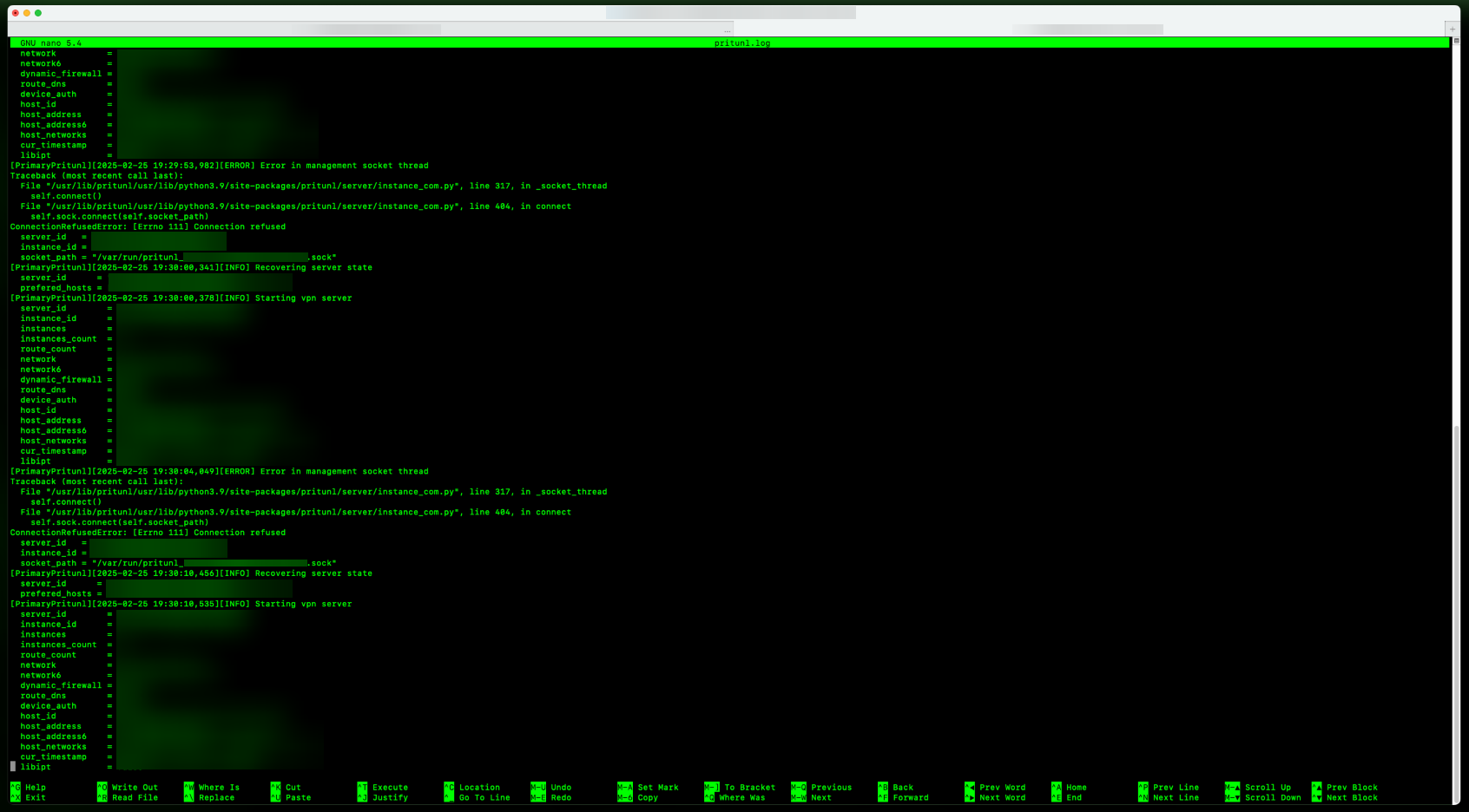

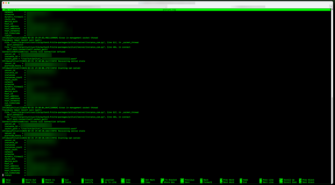

Hi @zach , I’ve finally got some logs.
A couple of errors I noticed;
Error in management socket thread
Connection refused
Any ideas on what these could point to? Thanks for your help.

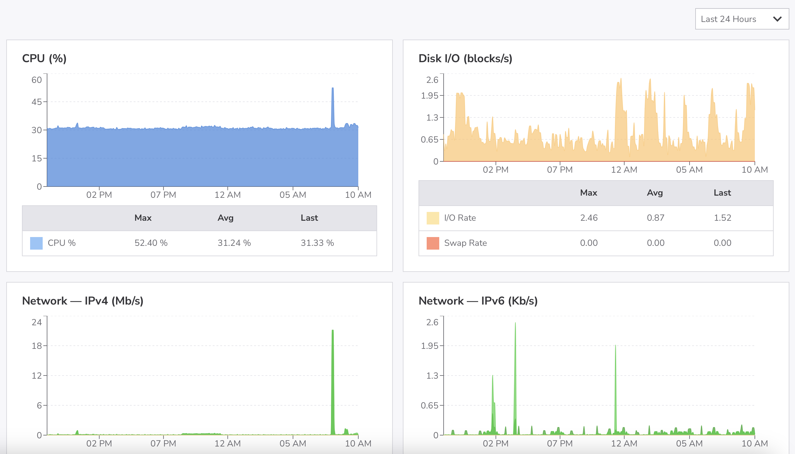

This first screenshot is what it looks like most of the time - this is from the cloud VM host:

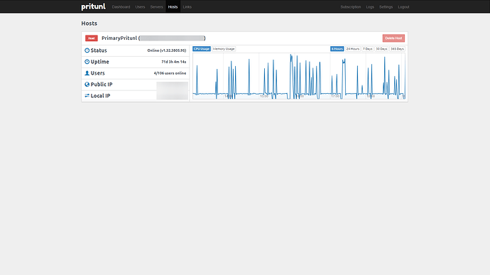

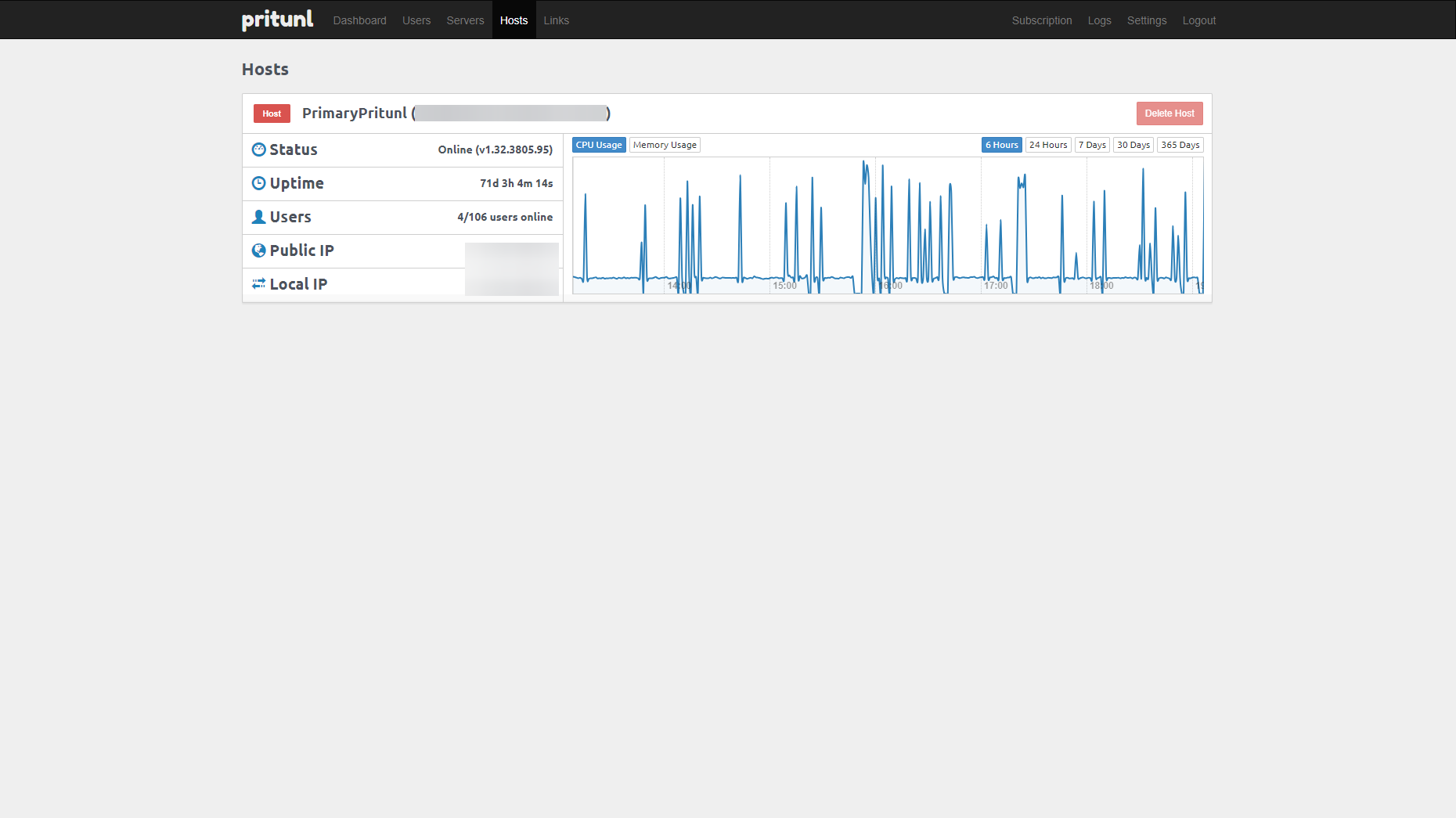

This second screenshot is from when it crashes. You can see a few spikes, but it’s not pinned at 100%. This graph is from Pritunl (not the cloud VM host):
The MTU or comp-lzo warnings won’t cause the server to crash or increase load on the server. If there’s nothing in the output indicating what caused the process to exit run sudo dmesg -THk and look for out of memory errors or other errors. Also run sudo journalctl --lines=5000 and check for errors.

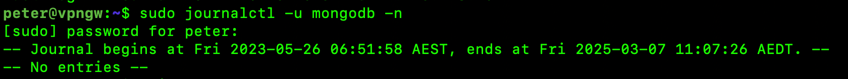

when I do sudo journalctl -u mongodb -n (on each of the 3 servers), I get nothing. See attached screenshots.
