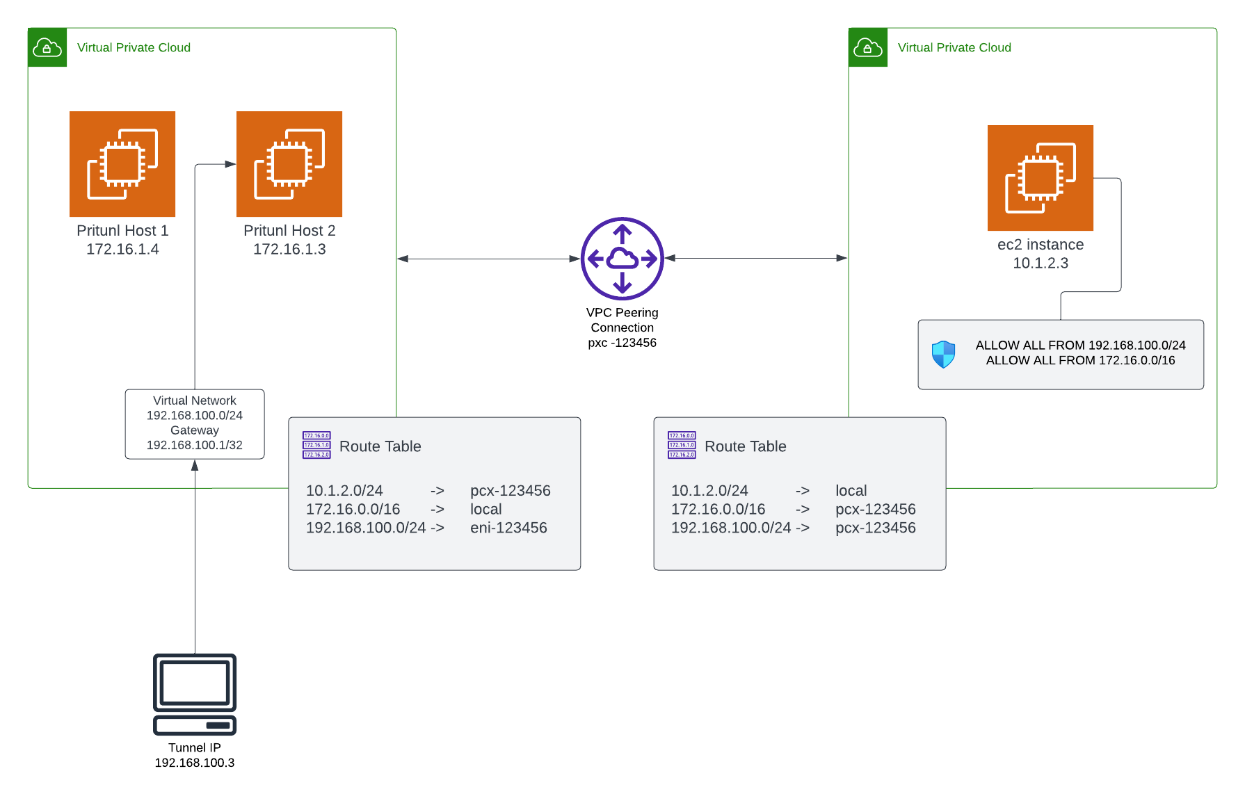

When removing NAT, I am unable to route beyond the tunnel adpater (192.168.100.1)
I have followed the documentation here and I can’t make it work without NAT.
  • The virtual network is Cloud Advertised (AWS)
  • The VPC containing the Pritunl Host is peered with the VPC that contains the target
  • Both VPCs have routing tables with the relevant entries
  • The target instance has appropriate security group
  • Unchecked Restrict Routing
  • NAT’d route works fine

Restrict routing should not be disabled, that will not effect support for the configuration. Source/dest checking must be disabled from AWS on the Pritunl instances.
AWS VPC peering will only route the peered VPC networks, the system does not support any external networks. For the configuration to work the VPC peering must be replaced with either AWS Transit Gateway or pritunl-link.
The MTU is only set on the server, the server will provide the MTU to the client.
Hi Zach. Thanks for the reply! It didn’ work with Restrict Routing checked, so I thought I’d “losen” it until I got things working.
“External” meaning the virtual network (that is cloud advertised) in an ec2/pritunl host? So, for my setup, I either need transit gateway or a link?
Any network that is not a AWS VPC subnet will not get routed over the VPC peering. The setup in that diagram will require some other linking method.
