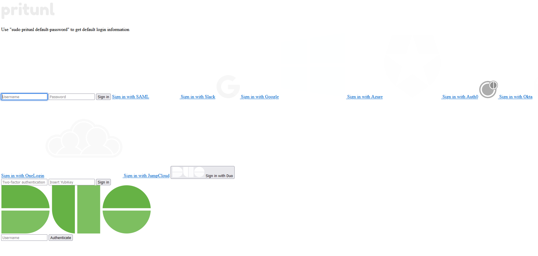

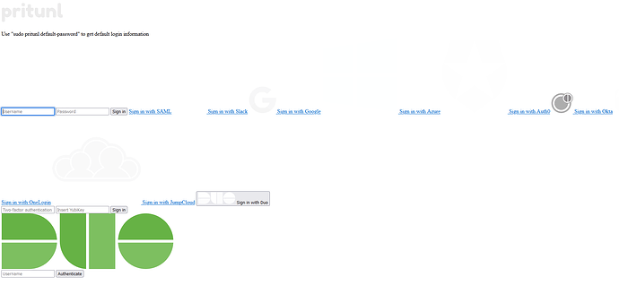

This is what the page looks like on port 443 via Nginx

Your change didn’t help me, the page didn’t open either, but after reading the errors from the browser console, I was inspired to think that it wouldn’t be a bad idea to have it statically look at the directory and here’s the working server config via nginx. I’ll share it here so as not to waste time.
