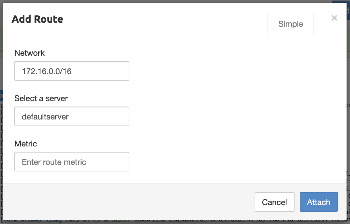

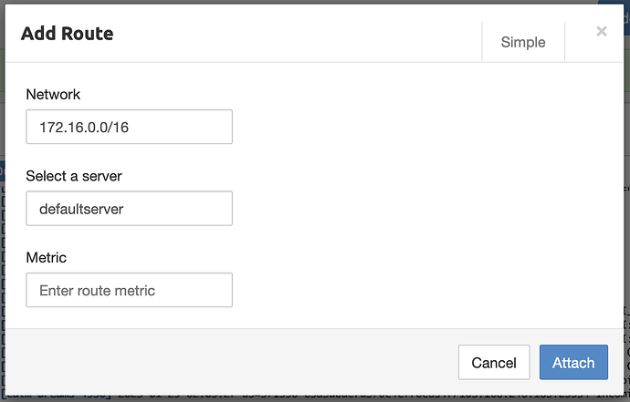

Thanks for reply. While adding route I don’t see NAT option, attaching screenshot for same.
I have tried testing after disabling source/des check at Pritunl Instance in AWS and adding 0.0.0.0/0 route still no difference.
NAT can only be disabled with a subscription. If the server has never had a subscription the routes will all have NAT enabled.
