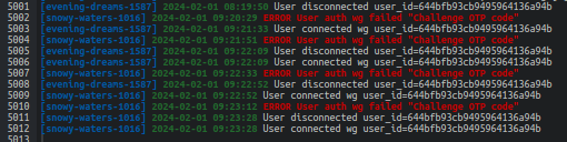

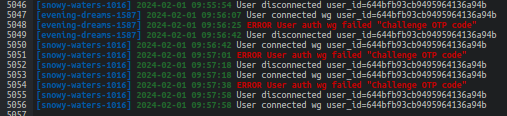

Hi @zach
I haven’t added your code or tested it yet. But I have enabled the use of custom cache "pritunl set app.sso_cache true" and I am testing (connect and disconnect several times) the VPN client. And I see that sometimes the client tries several times to connect to the server. And only on the 2nd or 3rd try it succeeds. But I enter MFA only once when I start the client for the first time. I think this shows that it’s not the client’s Google MFA.
In Pritunl VPN server logs:
I tested this on an Ovpn and WireGuard connection.

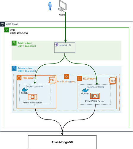

I use AWS, LB → 2 EC2 instances (Pritunl server in Docker container on these instances). And this EC2 instances in 2 availability zones (us-east-1a, us-east-1b)
My infrastructure looks like this
Thanks a lot!
The WireGuard connection design in Pritunl isn’t going to work with a network load balancer. The server will expect the client to connect to the same server that received the authentication request. A load balancer can be used in front of the Pritunl web server but not for both with WireGuard connections.

Or if we use WireGuard type connection, we need to use only one “big instance” of Pritunl server?
Or how we need to reconfigure Pritunl VPN in redundant mode?

I use load balancer before 2 Pritunl servers with enabled WireGuard servers like in the diagram above. Use 1 IP for LB. And that WireGuard needs to use one Pritunl server per VPN server?
Am I correct in understanding that in Pritunl cluster mode, WireGuard will not work as it should?
