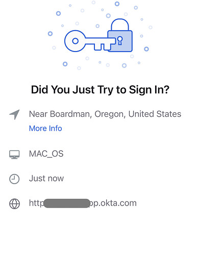

It looks like the x-forwarded-for address if pulling a variable called remote_ip defined in authorizer.py perhaps. With our server hosted in AWS us-west-2 (oregon) the location in the Okta Push is misleading. Is it possible to update this value to be the requesting users public IP?

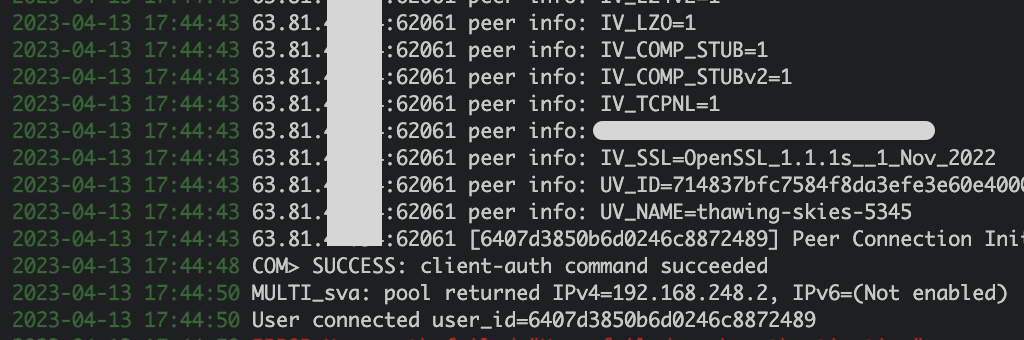

Hey @zach – We don’t use a load balancer but it seems like the IP in the connection log is correct, but that is not what is passed to the api call in okta.py.
In my screenshot, The greyed out section is my actual IP:
But when I initiate the push it shows a different IP/location.

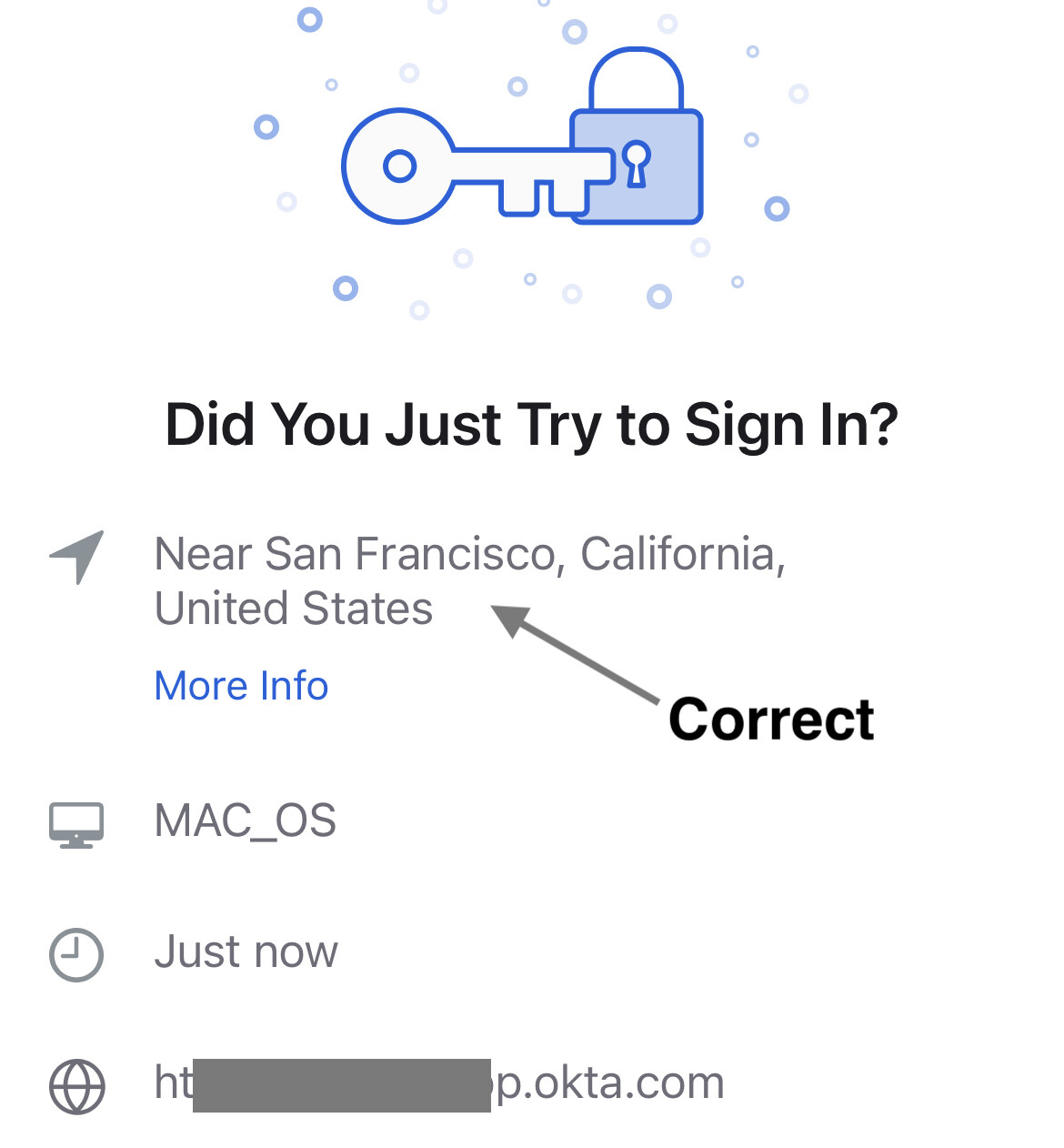

I can verify that this works by manually making an API call to okta verify push. If I set that 63.81... address in the X-Forwarded-For, it sets the correct location.
A lot of connection methods will use HTTPS requests before the OpenVPN connection such as single sign-on connection authentication. The IP address would be obtained from that request not the VPN connection.

When you are making the API call manually that is likely using the IP address of that computer. The issue will likely need to be fixed by Okta to use the header.
Try adding pritunl public IP as a Trusted proxy IPs in Okta admin settings:
Okta → Security → Networks
This does work well for us.
Hey @fmalykh – yeah at first test, this seems to work :slight_smile: thanks for the tip!
