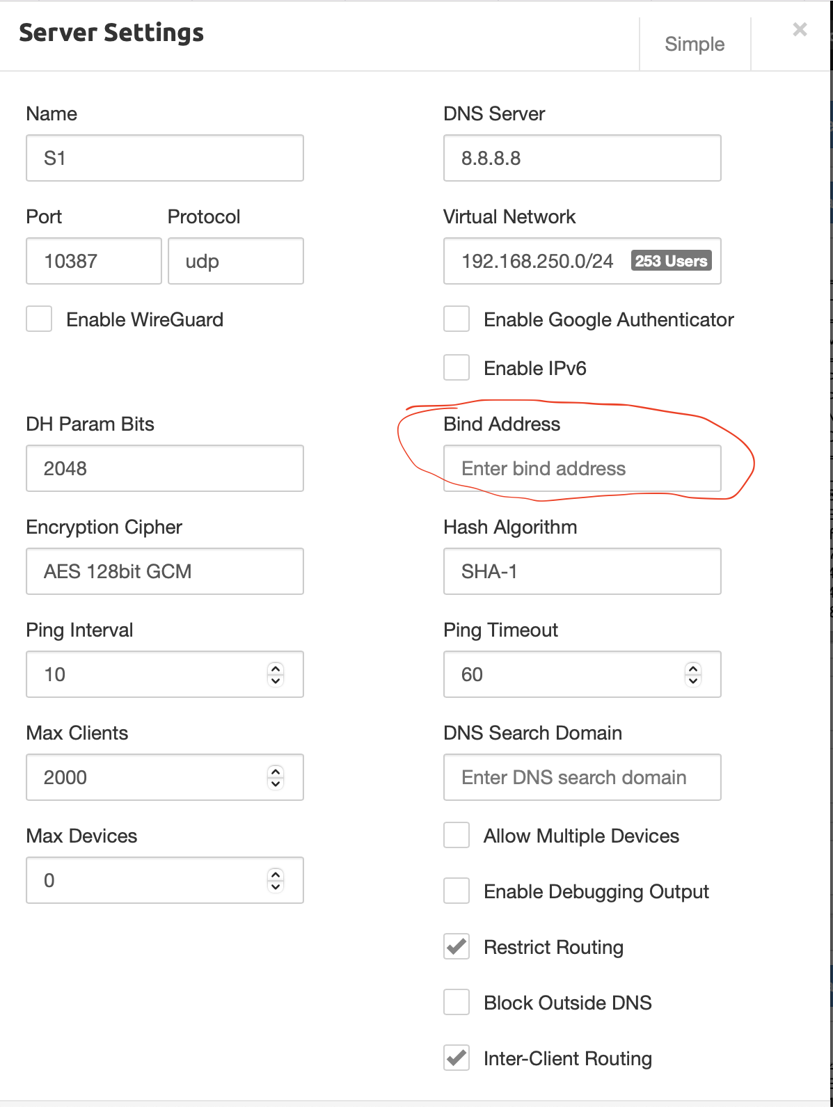

I have a vps with two ips (1 main and another additional IP) I installed Printunl and everything works fine with the Main IP, with the additional IP no user can connect…I asked for help because I wanted so much to connect the vpn with the Main IP as with the additional IP
Thank you so much
By default the Pritunl server will bind to all IP addresses unless the bind address option is set in the server settings.
I put it in the Bind Address (Additional IP) but it is not working, it connects but does not assign an internal ip.
log
r: TLS key negotiation failed to occur within 60 seconds (check your network connectivity)
[winter-fields-1749] Fri Jun 3 09:49:10 2022 xxx xxx xxx xxx :63500 TLS Error: TLS handshake failed
[winter-fields-1749] Fri Jun 3 09:49:13 2022 xxx xxx xxx xxx:51547 TLS Error: TLS key negotiation failed to occur within 60 seconds (check your network connectivity)
That is likely a configuration or firewall issue with the other IP address.
