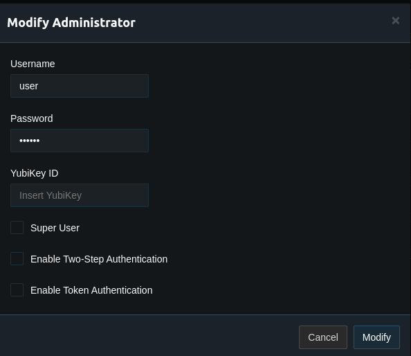

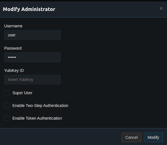

The Enable Token Authentication option must first be enabled.

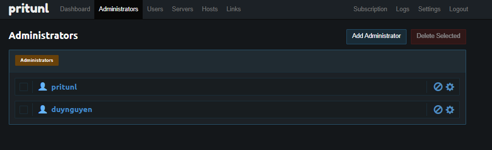

@zach I cant find any option for Enable Token Authentication . where does it locate?
Click on either the name of the administrator or the gear icon on the right side of the user in administrators page to open the settings where those options are located.
