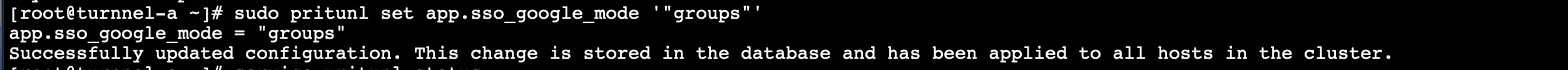

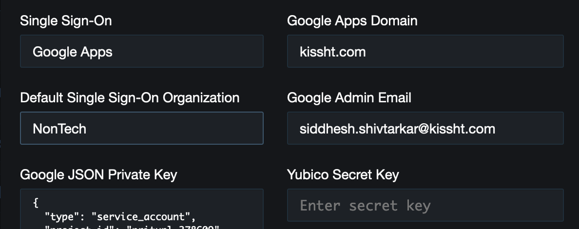

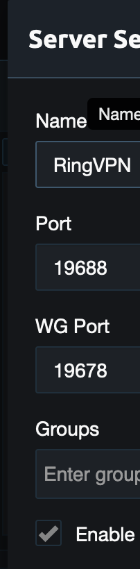

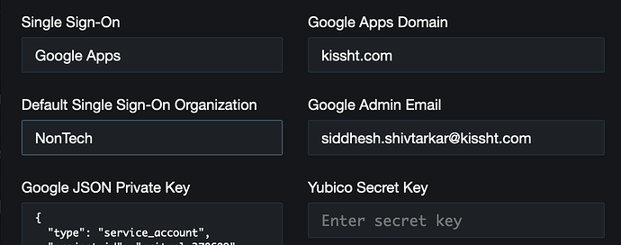

This doesn’t not help in fixing issue. Attaching you screenshots.
Enabled groups option using priutnl command you mentioned and no groups is specified in server setting, still getting same error message.
That command shouldn’t be used to fix the issue, only to switch to the groups mode. If you are not intending on using the groups mode run sudo pritunl unset app.sso_google_mode. First verify the user is in the correct organization and check the title at the top of the profile page after authenticating which will show the organization name. Then verify this organization is attached to a server. Do not attempt to create the single sign-on user manually, this will create a local type user. The user should be created by the Pritunl server during the single sign-on authentication.

i’m not sure if i’m doing something wrong at Google Apps end or Pritunl but single sign on not working for selected group.Can you help things I need to check at google end also?
You may be missing one of the required values in the top right settings. Matching groups requires the Google Admin Email and Google JSON Private Key.
Hi Zach,
I have Google Json private key and email id. Things works fine without group option. But we want to restrict vpn for selected group that we are unable to do.
